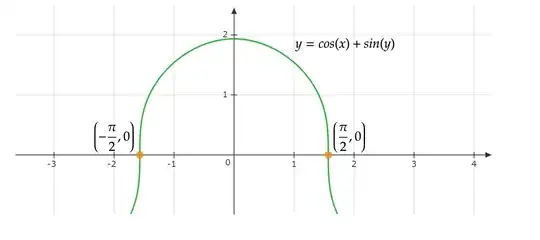

So I want to find the area of this circular looking thing.
I had the following thought process in solving it.

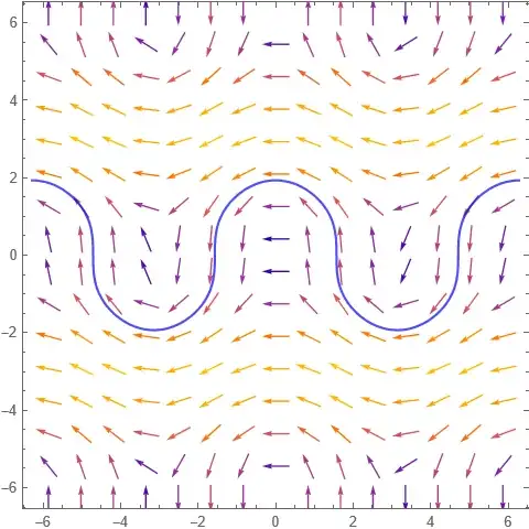

Then consider a parametric equation $r(t)=\begin{bmatrix} x(t) \\ y(t) \end{bmatrix}$ that lines up with the implicit differentiation above i.e. $r'(t)=\begin{bmatrix} x'(t) \\ y'(t) \end{bmatrix}=\begin{bmatrix} \cos(y(t))-1 \\ \sin(x(t)) \end{bmatrix}$. This is what the vector field $\begin{bmatrix} x \\ y \end{bmatrix} \to \begin{bmatrix} \cos(y)-1 \\ \sin(x) \end{bmatrix}$ looks like superimposed on the graph.
The derivative vectors go anticlockwise relative to the graph, which gave me an idea. Take Green's theorem: $\displaystyle \oint_C \vec{F} \cdot \vec{dr} = \iint_R \nabla \times \vec{F} dA$ and apply it to this problem in an interesting fashion.

I got stuck at this assortment of half-ideas. Of course I can write the equation in terms of x like this: $f(y) = \cos^{-1} (y - \sin(y))$, do approximations to get the upper y bound at the crest of the thing like this: $a = \cos(0) + \sin(a) \implies a = 1 + \sin a$ then approximate an integral to get the answer like this: $\text{Area} = 2\displaystyle \int_0^a \cos^{-1} (y - \sin(y)) \mathrm{d}y$, which gives me this answer to several decimal places: $4.9296448613689990829170456909320900725529417147308463240261037884$.
But that's boring. Is there any other way?
