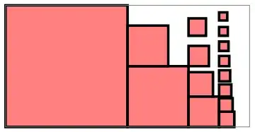

With fewer words. Hopefully clear enough. Oresme's style, but converging this time, and proving that the sum is $<2$.

Do you happen to have a source for this? I'd like to see others like this if there is some central repository... – daniel Aug 22 '13 at 19:50
1I've seen it in some calculus book. I reproduced this with Mathematica. – Jyrki Lahtonen Aug 22 '13 at 19:50
May be, @Pedro. First I had no borders at all, then very thin ones, then way too thick. This is a compromise. I agree with you in the sense that the next stack would look horrible with this border thickness. Too bad I already closed the notebook. Also, there would be more orphaned images at imgur :-/ – Jyrki Lahtonen Aug 22 '13 at 20:03
2This is a very good illustration of the cauchy's condensation test that for a positive non-increasing function $f(n)$ the series $\sum f(n)$ and $\sum 2^{n}f(2^{n})$ converge/diverge together. – Paramanand Singh Oct 05 '13 at 10:44
