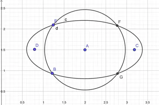

Comment: As shown in picture for each point of intersection, we must have a system of two equations of first degree $C(x.y)=c$ which represent the circle and $E(x, y)=e $ which represents the ellipse. These equations are resulting from factorization of equations of circle and ellipse to first degree factors. Suppose we get :
$Circle: C(x, y)=c_1\cdot c_2$
and from ellipse:
$Ellipse: E(x, y))=e_1\cdot e_2$
then we have to search for solution of following system of equations of first degree:
$\begin{cases}C(x, y)=c_1\\E(x, y)=e_1\end{cases}$
$\begin{cases}C(x, y)=c_1\\E(x, y)=e_2\end{cases}$
$\begin{cases}C(x, y)=c_2\\E(x, y)=e_1\end{cases}$
$\begin{cases}C(x, y)=c_2\\E(x, y)=e_2\end{cases}$
which give the coordinates of points E, F, G and B, in case they intersect. You may find one, two, three or four solutions or nothing at all(when all systems are inconsistent).
