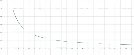

So instead of $\sin(x)^2$, let's consider the periodic function: $$ f(x) := \begin{cases} 0 &\text{if } \lfloor x\rfloor \text{ is even}, \\ 1 &\text{if } \lfloor x\rfloor \text{ is odd}, \end{cases} $$ which just alternates between $0$ and $1$ every interval of length $1$. Now we can consider the simpler integral: $$ \int_0^\infty \frac{f(x)}{x}\,dx. $$ Here's a graph of what $\frac{f(x)}{x}$ looks like
Notice that our integral becomes a sum of integrals of $\frac{1}{x}$ over every other interval of length $1$: $$ \int_0^\infty \frac{f(x)}{x}\,dx = \sum_{n=1}^{\infty} \int_{2n-1}^{2n} \frac{1}{x}\,dx, $$ but since $x\mapsto\frac{1}{x}$ is a decreasing function, we can bound it by the upper limit of these integrals, and so: $$ \int_0^\infty \frac{f(x)}{x}\,dx \geq \sum_{n=1}^{\infty} \int_{2n-1}^{2n} \frac{1}{2n}\,dx = \sum_{n=1}^{\infty} \frac{1}{2n}. $$ But the harmonic series $\sum_{n=1}^{\infty} \frac{1}{n}$ is famously divergent, and so our integral diverges too! In fact, one of the ways to show the harmonic series diverges is to compare it to the whole integral of $\frac{1}{x}$ over $(1,+\infty)$.

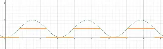

More precisely, since $\sin^2(x) \ge \frac12$ for $(n+\frac14)\pi \le x \le (n+\frac34)\pi$,
$\begin{array}\\ \int_{n\pi}^{(n+1)\pi}\dfrac{\sin^2(x)dx}{x} &\ge \int_{(n+\frac14)\pi}^{(n+\frac34)\pi}\dfrac{\sin^2(x)dx}{x}\\ &\ge \int_{(n+\frac14)\pi}^{(n+\frac34)\pi}\dfrac{dx}{2x}\\ &\ge \dfrac{\pi/2}{2(n+\frac34)\pi} \qquad \text{(width }\pi/2) \\ &\ge \dfrac1{4(n+1)}\\ \end{array} $
and the sum of these diverges.
