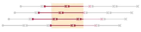

Consider a type of event that has fixed duration $\delta$. Let $\lambda$ be the rate of events starting / ending (assuming steady state). I want to derive the expected number of events observed (partially or fully) in a given period $T$. If $\delta \approx 0$, this should converge on the Poisson distribution.
diagram
Edit: sorry, I'm not just seeking the expected number of events (i.e. mean), but the expected distribution of observed event counts: $p(x|\lambda,\delta,T)$.

  • I think you have an infinite server system where each new job immediately gets its own server and has fixed service time $\delta$. Jobs arrive at rate $\lambda$ jobs per unit time, meaning $$\lim_{t\rightarrow\infty} \frac{\mbox{Number of arrivals during $[0,t]$}}{t}=\lambda \quad (wp1)$$ Then, Little's theorem $\overline{N}=\lambda \overline{W}$ says the average number of jobs in the system is $\overline{N}=\lambda \delta$. Little's theorem does not require the arrival process to be a Poisson process. The same result holds if service times are random i.i.d. with average $\delta$. – Michael Jul 07 '23 at 19:42
  • Thanks, but I am interested in the expected number of jobs observed over the interval (including 'tail ends', complete jobs (if $\delta < t$), and 'ongoing' jobs), not the expected number of jobs at any instantaneous moment. – jessexknight Jul 07 '23 at 19:48
    If you fix a particular interval, say, $[1.3, 2.4]$, then nothing can be said without more assumptions since a general arrival process of rate $\lambda$ may very well have (with prob 1)no arrivals until after time $2.4$, or it could have a million arrivals before time $2.4$. The "rate $\lambda$" is describing a limit as time goes to infinity, so transient behavior does not affect the limit. On the other hand, if the arrival process is Poisson of rate $\lambda$, the average number of arrivals over any interval of size $t+\delta$ is exactly $\lambda (t+\delta)$. – Michael Jul 07 '23 at 19:50
  • Sorry, I don't understand how this is different from deriving the Poisson - is it sufficient to assume steady state? I am reading this re. Little's Law in practice... – jessexknight Jul 07 '23 at 19:55
  • You need to specify your assumptions on the arrival process. Is it a Poisson arrival process? If not, what properties does it have? If you say nothing else, I will assume it is a deterministic process that has its first arrival at time 9.8 and periodically has a single arrival every $1/\lambda$ seconds thereafter. – Michael Jul 07 '23 at 19:56
  • Ah, I think I understand... yes, let's assume arrivals are Poisson-distributed with rate $\lambda$. – jessexknight Jul 07 '23 at 20:02
  • So we have a $M/D/\infty$ queue with fixed service times $\delta$. Now consider our interval $[t_0, t_0+T]$ and suppose $t_0\geq \delta$. The number of distinct jobs we observe in the queue over that interval are all the arrivals during $(t_0-\delta, t_0]$ (all such are still in the queue at time $t_0$) and all the arrivals during $(t_0, t_0+T]$. This is the number of arrivals over the interval $[t_0-\delta, t_0+T]$ and has expectation $\lambda (\delta + T)$. This answer changes slightly if $t_0<\delta$, in which case all arrivals during $[0, t_0)$ are still in the system at time $t_0$. – Michael Jul 07 '23 at 20:04
  • Thanks! I think I can confirm this result via simulation. However, I am interested in a parametric distribution $p(x | \lambda, \delta, T)$, which should then have mean $\lambda (\delta+T)$. – jessexknight Jul 07 '23 at 20:09
  • The number of Poisson arrivals during an interval of size $\delta + T$ has a distribution given by the Poisson mass function of parameter $\lambda (\delta + T)$. So if $N$ is the number then $P[N=k]=\frac{\lambda^k(\delta+T)^k}{k!}e^{-\lambda(\delta+T)}$ for $k \in {0, 1, 2, ...}$. – Michael Jul 07 '23 at 20:11
