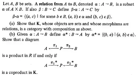

The following question is taken from Arrows, Structures and Functors the categorical imperative by Arbib and Manes.
$\color{Green}{Background:}$
Let $A, B$ be sets. A $\textbf{relation from} A$ to $B$, denoted $\alpha:A\to B,$ is a subset $\alpha$ of $A\times B.$ If also $\beta: B\to C$ define $\beta\cdot \alpha: A\to C$ by
$$\beta\cdot \alpha=\{(a,c)\mid \text{ for some }b\in B, (a,b)\in \alpha \text{ and } (b,c)\in \beta \}$$
$(a)$ Show that $\textbf{K},$ whose objects are sets and whose morphisms are relations, is a category with composition as above
$(b)$ Given $\alpha:A\to B$
define
$\alpha^{*}:B\to A$ by $\alpha^{*}=\{(b,a)\mid(a,b)\in \alpha\}.$
Show that a diagram
$$A\xleftarrow{\pi_1}P\xrightarrow{\pi_2}B$$
is a product in $R$ if and only if $$A\xrightarrow{{\pi_1}^{*}}P\xleftarrow{{\pi_2}^{*}}B$$
is a coproduct in $\textbf{K}$

  • @S.C. I attached a screenshot of the original question. – Seth Jul 05 '23 at 19:06
  • You have not defined what "$R$" is, as S.C. has already said. The screenshot does not help with that... Without that we cannot (help you to) answer the question – FShrike Jul 06 '23 at 11:39
  • @FShrike the question did not defined what $R$ is other than it says there is a product in $R$. Am I not reading or misunderstanding the wording of the question? – Seth Jul 06 '23 at 12:15
  • $R$ has to be some kind of category. Alex is suggesting the authors made a typo and that we should have $R=\mathbf{K}$. Do the authors ever define a category $R$, anywhere?? – FShrike Jul 06 '23 at 12:32
