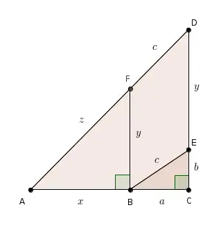

Add the first equation to twice the second and to the third and express the result as
$$ (x+a)^2+(y+b)^2=(z+c)^2 $$
Draw the following triangles to illustrate this equation as well as the equations
$$x^2+y^2=z^2 $$
and
$$a^2+b^2=c^2$$
Quadrilateral BEDF has parallel sides BF and ED both equal to $y$, so it is a parallelogram, with both BE and FD equaling $c$.
So $\triangle ABF$ is similar to $\triangle BCE$.
So $\dfrac{y}{x}=\dfrac{b}{a}$ and $\dfrac{z}{x}=\dfrac{c}{a}$.

  • "sides BF and ED both equal to y". How do you know that? Of course you can e.g. construct DE = y, but then how do you know that the point F, which splits AD into z and c, when dropped to B (which splits AC into x and a) is perpendicular? Or, alternatively, construct BF = y, but then how do you know ED = y? In other words, I can construct either one of those two segments equal to y, but don't see how to prove the other then is.
    – SRobertJames Jun 29 '23 at 17:59
  • By the construction we know that ED is parallel to BF and that both have length y. So it follows that BEDF is a parallelogram, So BE is parallel to FD and to AD and FD has length c. A clearer construction would have been to raise the $\triangle BCE$ to the top of $\triangle ACD$ so that its diagonal was segment FD rather than BE. – John Wayland Bales Jun 29 '23 at 18:17
