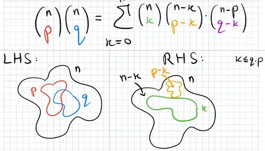

$$ \sum_{k=0}^{\min\{p,q\}} \binom{n}{k} \binom{n-k}{p-k} \binom{n-p}{q-k} = \binom{n}{p} \binom{n}{q}$$
My attempt
  • First of all, I want to find a combinatorial proof since it's important for me to understand the "combinatorial story" behind it.
  • I draw this in order to understand maybe what's the "story". But I'm stuck understanding what are the purple elements and the whole connection to the LHS (Note that the index k "runs" over vaules from $0$ to $\min{(p,q)}$). enter image description here
I would appreciate if someone here can try to continue my solution or suggest an alternative solution (if you do please explain each step the motivation behind it).

  • Hint: given $n$ people, form two not necessarily disjoint subcommittees therein, one of size $p$, the other size $q$. You can do this by choosing which $k$ people are in both, for $0\le k\le\min{p,,q}$. – J.G. Jun 28 '23 at 11:09
  • I think, but would have to check again, that the english translation of these countings is that we are trying to count different 2 subsets of a set of $n$ elements, where the first one has $p$ elements and the second one has $q$ elements. Then the LHS (in your image) is clear what it does... For the second, RHS, we observe that the intersection of these 2 sets has at most min$(p,q)$ elements. So we count by that. Then we complete the set of $p$ elements with the second binomial coefficient, and then we complete the set of $q$ elements with the last binomial coefficient. Does this help? – cnikbesku Jun 28 '23 at 11:10
  • So, your attempt is good. You should notice next that green contour + orange contour has $p$ elements, and then that the green contour + (missing) magenta contour has $q$ elements. – cnikbesku Jun 28 '23 at 11:13

As to your diagram, consider drawing a third disjoint blob in the diagram on the right in purple color. Then on the left-hand side, you can create a third region which is the intersection between red and blue, thereby obtaining three disjoint regions.
