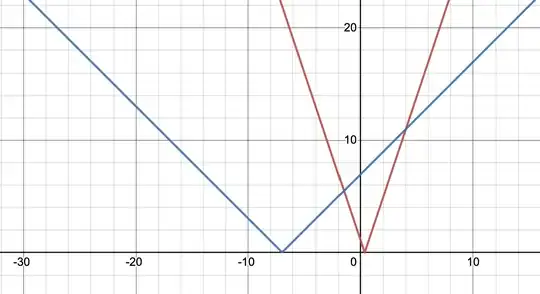

Note that if $a$ is divisible by $b$, then $|b| \leq |a|$. So, a necessary (but not sufficient) condition is $|3n - 1| \leq |n + 7|$. Going the lazy route, we can plot the graphs $y = |3x - 1|$ in red and $y = |x + 7|$ in blue and see:
We see that $-\frac{3}{2} \leq n \leq 4$, so we only have to consider the cases $n \in \{-1, 0, 1, 2, 3, 4\}$.
