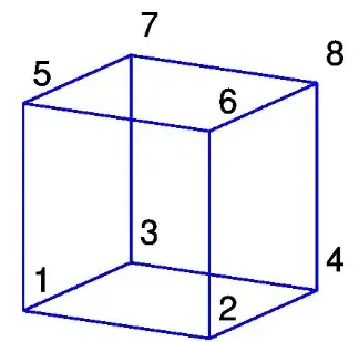

Consider the "adjacency matrix" of the cube, considered as an "undirected graph" :
$$A=\left(\begin{array}{cccccccc} 0&1&1&0&1&0&0&0\\ 1&0&0&1&0&1&0&0\\ 1&0&0&1&0&0&1&0\\ 0&1&1&0&0&0&0&1\\ 1&0&0&0&0&1&1&0\\ 0&1&0&0&1&0&0&1\\ 0&0&1&0&1&0&0&1\\ 0&0&0&1&0&1&1&0 \end{array}\right)$$
In every column of $A$, there are 3 "ones", accounting for the three neighbouring vertices for a certain ordering of the vertices of the cube. For example, in the first column, $A_{1,2}=A_{1,3}=A_{1,5}=1$ meaning that vertex $1$ has neighbouring vertices $2,3$ and $5$, etc.
The interest of this matrix is that the generic element $P_{i,j}$ of its k-th power $P:=A^k$ gives the number of different ways one can go from vertex $i$ to vertex $j$ in $k$ steps.
For example, consider :
$$A^2=\left(\begin{array}{cccccccc} 3&0&0&2&0&2&2&0\\ 0&3&2&0&2&0&0&2\\ 0&2&3&0&2&0&0&2\\ 2&0&0&3&0&2&2&0\\ 0&2&2&0&3&0&0&2\\ 2&0&0&2&0&3&2&0\\ 2&0&0&2&0&2&3&0\\ 0&2&2&0&2&0&0&3 \end{array}\right)$$
We indeed see that there are
  • 3 ways to go from vertex 1 to itself in two steps (by going to one of its three neighbours then backtracking).
  • 2 ways to go from vertex 1 to vertex 4 in two steps (indeed, they occupy two opposite vertices on a same face of the cube).
It now remains to consider, in $A^6$, the upper left entry which is $183$, somehow larger than the result you have found.
Matlab program :
clear all;close all;hold on;view(30,15);axis equal off;
V=[0,1,0,1,0,1,0,1
   0,0,1,1,0,0,1,1
   0,0,0,0,1,1,0,1];  % the 2^3=8 vertices of the cube
% generation of the upper part of matrix A :
A=zeros(8);
for p=1:8;
   for q=p+1:8;
      if (norm(V(:,q)-V(:,p))==1)
         A(p,q)=1;Z=[V(:,[p,q])];
         plot3(Z(1,:),Z(2,:),Z(3,:),'linewidth',5,'b');
      end;
   end;
end;
A=A+A'; % taking symmetry of A into account
B=A^6;
B(1,1)
text(V(1,:)+0.05,V(2,:),V(3,:)+0.15,
{'1','2','3','4','5','6','7','8'});

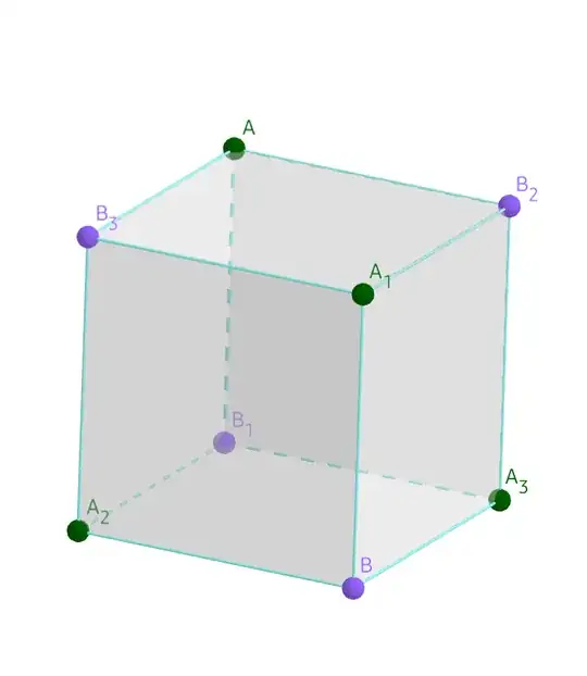

Here's one more approach, using the principle of exclusion inclusion,
In the cube, mark the alternate vertices with green(denote this family of points by $A^*$) and purple($B^*$ ) colours as shown in the diagram. Note that for any move, the bead alternates between a $A^*$ and a $B^*$ in each move. Suppose the bead starts from the vertex $A$ and let the diagonally opposite vertex of $A$ be $B$.
Since, the bead alternates the $A^*$ and the $B^*$ for any possible move of the bead, it should be at a $B^*$ after its $5^{{th}}$ move. Note that all the $B^*$ except $B$ are adjacent to $A$, and hence it can reach $A$. So, we need to subtract the number of ways to reach $B$ from the total number of ways for the $5$ moves.
There are a total of $3$ paths to choose for the bead from each vertex and hence total of $3^5$ ways for the $5$ moves. And let $N$ be total such games which have been asked.
$$N=3^5-(\text{no. of ways to reach $B$ in $5$ moves})$$
After $4$ moves, the bead must be at $A^*$ and all the $A^*$ except $A$ are adjacent to $B$, and hence, it can move to $B$. So,
$$\text{No. of ways to reach $B$ in $5$ moves} = 3^4 - (\text{No. of ways to reach $A$ in $4$ moves})$$
Similarly arguing we get,
$$\text{No. of ways to reach A in $4$ moves} = 3^3 - (\text{No. of ways to reach $B$ in $3$ moves})$$
So we get,
$$N=3^5 - (3^4 - (3^3 - (3^2 - (3 - (\text{no. of ways to reach $B$ in $1$ move})))))$$
Since $A$ and $B$ are not adjacent and the bead starts from $A$, there is no way for the bead to reach $B$ in $1$ move.
$$N=3^5−3^4+3^3−3^2+3=183$$

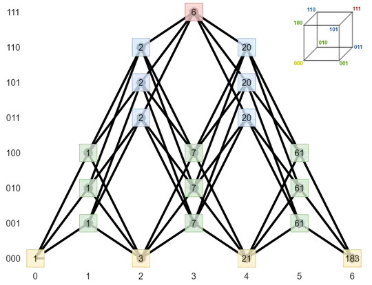

Here is a nice visual solution to the problem. The number at any given vertex is the sum of the numbers associated to the vertices connected by incoming edges (i.e. the sum of all connected left neighbors). The numbers represent the number of $k$-step paths from $000$ to that vertex.
