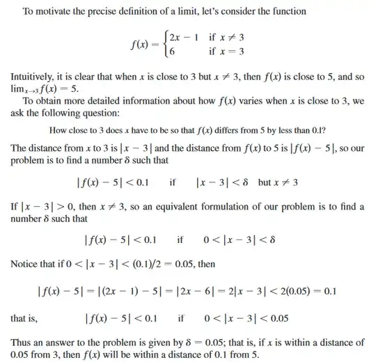

I'm going through a Calculus class for the third time, and I understand everything very basically. I'm able to solve simple limits, derivatives, and integrals, but I can never really comprehend what I'm doing and the logic behind it. I'm on my third Calculus book, and I chose Stewart because I heard it's simpler. I couldn't get past the properties of numbers in the previous ones.
I can (now) understand the entire logic that's going on here. However, I can't understand why he makes some assumptions that allow the logic to happen (not sure if that's the right way to put it). They're not really assumptions, I just don't know why these things appear.
For example, he writes:
Notice that if $0 < |x - 3| < \frac{0.1}{2} = 0.05$, then $|f(x) - 5| = |(2x - 1) - 5| = |2x - 6| = 2|x - 3| < 2(0.05) = 0.1$
How did he know delta is 0.05? How does that prove anything about that bunch of equations and inequalities? When I first read this paragraph I though it meant something like
Notice that if (I assume that delta is half of epsilon) then (this string of equations and inequalities is true)
But a friend explained to me that said string is actually how you arrive at delta. As in, it's a proof of the previous assumption. She rewrote it to me like this and it made sense:
$$|f(x) - 5| < 0.1$$ $$|f(x) - 5| = |2x - 1 - 5| = |2x - 6| = 2|x - 3|$$ $$2|x - 3| < 0.1$$ $$|x - 3| < \frac{0.1}{2} = 0.05$$
Now I'm reading Stewart's statement as
Notice that if (I assume that delta is half of epsilon) then (this string of equations and inequalities proves that I magically made the correct assumption)
I don't know if I'm right to think this statement is contrived. My friend wasn't able to help me past here because she doesn't understand what I'm asking anymore :(
Then I got another question, which is how $|x - 3| < \delta$ and $|x - 3| < 0.05$ being true prove that $\delta = 0.05$. It feels like that merely puts a roof on delta, as if it could be anything below 0.05. What if it's actually 0.005? I believe it's justified by saying that we obtained that number from $\varepsilon = 0.1$, so their relation are proven enough that for $\delta = 0.05$ it'll never result in an out of bounds epsilon. I just can't make the synapses to visualize that.
  • what your friend did was "backtracking". Assuming the final equation is true, she found the condition necessary for that to happen. Note that since $\delta = 0.05$ works, any value of $\delta$ which is less than $0.05$ will also work. – insipidintegrator Jun 26 '23 at 07:29

Let's now consider how Eloise might have arrived at her $\delta$. She appears, like Stewart, to have conjured up $\delta = \varepsilon/2$ almost out of thin air, but that's clearly not true. The key is to work backward from $\varepsilon$ toward $\delta$, and then once we get there, we show how to move forward from $\delta$ toward $\varepsilon$. Unfortunately, there is an aesthetic in much mathematical exposition that eschews showing the backward step, so the fact that the forward step works seems almost miraculous.
In fact, it's pretty straightforward, especially in this case. Remember, Eloise's goal is to force $2x-1$ into an $\varepsilon$-neighborhood of $5$, no matter what $\varepsilon$ is. So, she asks herself, how wide an interval around $x = 3$ will still yield a value of $2x-1$ in that neighborhood?
Here, we're aided by the fact that $2x-1$ is strictly increasing. (In fact, of course, it's linear, but never mind that now.) So in order for $2x-1$ not to be too high, we need
$$ 2x-1 < 5+\varepsilon $$
and for $2x-1$ not to be too low, we need
$$ 2x-1 > 5-\varepsilon $$
Adding $1$ to both sides and dividing by $2$, for both inequalities, yields
$$ x < 3+\frac{\varepsilon}{2} \\ x > 3-\frac{\varepsilon}{2} $$
That is, we're OK as long as we don't exceed $3$ by $\varepsilon/2$ or more, and as long as we don't fall short of $3$ by $\varepsilon/2$ or more. More succinctly, as long as we're closer to $3$ than $\delta = \varepsilon/2$, we're good. And this works no matter what value of $\varepsilon$ we're challenged with, so we are done!

Finally, as some other answers have pointed out, once we've identified a workable $\delta$-interval, any smaller interval will also work, because that smaller interval will always be a subset of the one we've already shown to work. In our example, if $\delta = \varepsilon/2$ works, then $\delta = \varepsilon/3$ will also work, as will $\delta = \varepsilon/4$, etc. So it's not always necessary to pick the largest possible interval; we just have to find one that works. Sometimes, we choose one that's smaller than strictly necessary, because it makes our demonstration easier. That's completely fine, so long as it's strictly positive; we can't have an interval of width $0$.

You could say that those equalities are both the way to find the appropriate $\delta$, and to actually prove that this $\delta$ works. I'll do the argument for a general $\epsilon$, not necessarily $0.1$, since this doesn't seem to be what's confusing you.
So let $\epsilon>0.$ We want to show that the limit of $f(x) = 2x-1$ as $x \to 3$ is $5$. To prove this, we need to find a $\delta>0$ such that $|f(x) - 5| < \epsilon$ whenever $|x-3| < \delta$.
At this moment you may have no clue which $\delta$ we could try, so let's just rewrite the statement above using the definition of $f(x)$. Note that for any $x$ $$|f(x) -5| = |(2x-1)-5| = |2x-6| = 2|x-3|.$$ So just from writing down the definition of $f(x)$, there's a very simple relationship between $|f(x) - 5|$ and $|x-3|$. From this you should be able to see why $\delta = \epsilon/2$ should work.
To see that it does work, we assume that $|x-3| < \epsilon/2$ and observe that then $$|f(x) -5| = |(2x-1)-5| = |2x-6| = 2|x-3| < 2 \cdot \epsilon/2 = \epsilon.$$

There is no such thing as the value of $\delta$. There can be many different values that work. As long as, whenever we have an $\varepsilon$, we find one value of $\delta$ that works for that $\varepsilon$, we have succeeded. In this case, when $\varepsilon = 0.1$, then $\delta = 0.05$ works. Sure, there are other values that work, but having found this one is enough.
