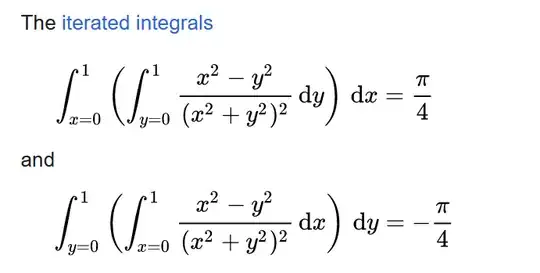

I was looking at the calculations of the integrals withing this post Why the Fubini theorem fail?? enter image description here
I was wondering about this equality $\int\int\frac{\partial}{\partial y}(\frac{y}{x^2+y^2})=\int \frac{y}{x^2+y^2}\big|_{y = 0}^{y = 1}dx$. I know this is possible if $f(x,y)$ is continuous, but clearly, $f$ is not continuous at $0$. Does someone know what is the measure-theoric argument for the equality?
