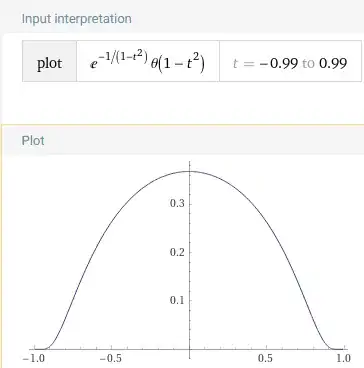

Now, if I want to focus in the behavior only in one point in space $x = x_0$, for ease lets say at $x_0 = 0$, then the behavior in time of $F(x,t)$ at $x=0$ will be given by the function: $$y(t) = F(0,t) = \begin{cases} e^{-\textstyle{\frac{1}{1-t^2}}},\quad t^2<1 \\ \quad 0\quad\;,\quad t^2\geq 1 \end{cases}\label{Eq. 5}\tag{Eq. 5} $$ which bell-like shape can be reviewed here.
eqn 5
