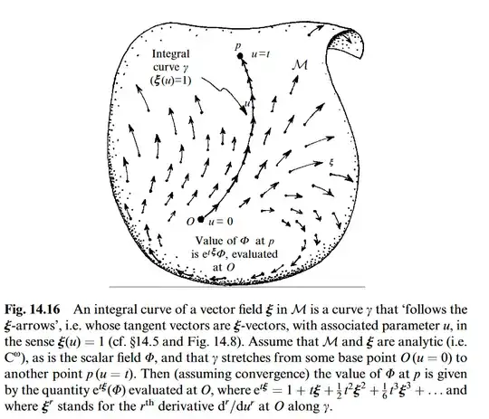

And that's it! That 's also the basis by the fancy shmancy category theory answer that tp1 wrote. It maybe remarked that the bracket evaluating trick thing I kept doing is also the basic idea for one shadowy version of calculus called Umbral Calculus
Why did this whole procedure "feel" like doing an integral?
See accepted answere here
Bonus : Shifting points of evaluation generally in higher calculus
Roger Penrose road to reality
The idea of linear approximation is quite profound, and more general single variable calculus itself. If we are to think of abstractly, it says to find the value at a little bit away, we add at the inital point plus the change in parameter * the rate of change function with that parameter. We have,
