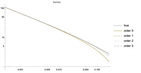

This appears to be the first term in Series expansion below. Using $x=2s^2$ replacement, the series looks like below
$$ \begin{array}{ccc} & \text{order} & \text{expr} \\ & 0 & \frac{\pi }{2 x}-\frac{\pi ^2}{4}-1 \\ & 1 & \frac{1}{8} \left(8 \pi +\pi ^3\right) x+\frac{\pi }{2 x}-\frac{\pi ^2}{4}-1 \\ & 2 & \frac{1}{48} \left(-32-36 \pi ^2-3 \pi ^4\right) x^2+\frac{1}{8} \left(8 \pi +\pi ^3\right) x+\frac{\pi }{2 x}-\frac{\pi ^2}{4}-1 \\ \end{array}$$

  • Would not a loglog plot be a better plot to see the local expansion around $s=0$? – Lutz Lehmann May 16 '23 at 08:22
