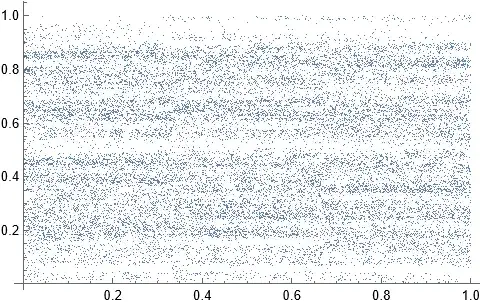

Someone gave my question a second chance. I have a function in mind but it's complicated to describe. I'm not sure the function gives what I want at the beggening of this post. My only evidence is a graph of countable points of the example at the end of the post.
I need a simpler function.

(e.g. $k(r)=10r+20$) you can use programming to visualize $f$ though I don't know if you can graph the entire function. (The programming I used is mathematica.)

f[x_] := f[x] = N[1 - ((1)/(10)) RealAbs[ Sum[g1[Sum[ RealDigits[x, 3, k[r], -r][[1]][[z]], {z, r + 1, k[r]}], r + 1]/(3^r), {r, 0, 8}] - 10]] (Defines function f,I assume the larger k[r]'s values, the more
the function appears dense in [0,1]x[0,1]
p = .00005 (Incremement between the x-values in the points of the
graph below
ListPlot[Table[{x, f[x]}, {x, p, 1, p}]] (Graphs countable points of the functions but is not a
complete accurate graph. There are uncountably many points that need
to be included.
Image of Code

I don't think the function $f$ in your example is non-measurable. Indeed, the functions $\operatorname{digit}_3$ and $g_r'$ are Borel functions, and the Borel function are closed under basic arithmetic operations and pointwise limits, including infinite series. Since your $f$ is defined using only such operations, it must be Borel, so in fact the preimage of every interval under $f$ is a Borel set and thus measurable.
