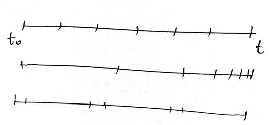

If the value of the stochastic integral $$ \int_{t_0}^tg(t',W_{t'})\mathrm{d}W_{t'} = \underset{n\to\infty}{\operatorname{ms-lim}}\sum_{i=1}^ng(\tau_i, W_{\tau_i})(W_{t_i}-W_{t_{i-1}})$$ does depend on the choice of $\;\tau_i:=\alpha\,t_i+(1-\alpha)\,t_{i-1}, \quad \alpha\in[0,1]$, why doesn't the choice of partitioning $[t_0,t]$ matter (and, indeed, this allows choosing equally spaced sub-intervals) ? Here are three different ways in which $[t_0,t]$ can be partitioned enter image description here

    Intuitively, I want to say the independent increments of Brownian motion and the fact $\max_{n}\Delta t \to 0$ is why the choice of partition doesn't matter. – oliverjones May 25 '23 at 15:47
The choice of partition $ t_0<t_1<\ldots<t_n = t$ and the choice of $\tau_i\in[t_i,t_{i+1}]$ are pretty much unrelated matters.

Why doesn't the choice of partitioning $[t_0,t]$ matter ?
Well, as you can see in the above argument, the choice of partition doesn't matter because the convergence holds for any partition whose mesh size $|\Pi_n|:=\sup_{0\le i\le n-1} |t_{i+1}-t_i|$ goes to zero. So you are free to take any partition you like, as long as the distance between two subsequents points converges to $0$ uniformly, the same result will hold, always (in most practical cases we pick a uniformly spaced grid because it is the easiest to work with, but there is no formal need to).
The proof is essentially an application of Itô isometry and Cauchy-Schwarz, and can be found in Proposition 14.16 of Schilling's Brownian Motion: An Introduction to Stochastic Processes. Intuitively, because you require the mesh size to uniformly converge to zero, you don't have any room to create any local bad behaviors, so under that constraint your sum will always converge to the same object.
