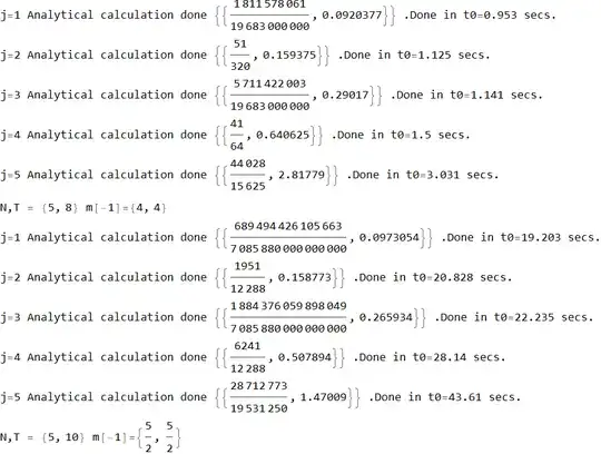

Now we are going to present a code snippet that uses equation $(2)$ along with the recurrence $(1)$ and confirms the result $(3)$. Here we took $N=5$, $p=-1$, $T= N+1-2 p+ 2 (0,1)$ and here we go:

NN = 5; p = -1; Do[(Loop over T values.) T = NN + 1 - 2 p + 2 xi; aa = (T - NN - 1)/2; S = 0; Clear[lmb]; Do[ a = Table[aa + If[xi == j, p, 0], {xi, 1, NN}]; A = ConstantArray[1, NN]; Ab = Accumulate[A]; t0 = TimeUsed[]; res = Flatten[ Table[{Table[ If[xi == NN, Total[a] + Binomial[NN + 1, 2], lmb[xi]] - If[xi == 1, 0, lmb[xi - 1]], {xi, 1, NN}], CC[NN, Table[ If[xi == NN, Total[a] + Binomial[NN + 1, 2], lmb[xi]] - If[xi == 1, 0, lmb[xi - 1]], {xi, 1, NN}], a] Product[ 1/ Ab[[xi]]^( If[xi == NN, Total[a] + Binomial[NN + 1, 2], lmb[xi]] - If[xi == 1, 0, lmb[xi - 1]]), {xi, 1, NN}]}, Evaluate[ Sequence @@ Table[{lmb[xi], If[xi == 1, 2, lmb[xi - 1] + 2], If[xi == 1, NN + a[[1]], Total[a] + Binomial[NN + 1, 2] - 1]}, {xi, 1, NN - 1}]]], NN - 2]; mres = Pfct[NN, T]/(NN T^p) 2^(Binomial[NN + 1, 2] + NN aa + p) Total[res[[All, 2]]]; S += mres; Print["j=", j, " Analytical calculation done ", {#, N[#]} & /@ {mres}, " .Done in t0=", TimeUsed[] - t0, " secs."]; , {j, 1, NN}]; S1 = Which[ p == -1, T/(T - NN - 1), p == -2, (T^2 (T - 1))/( Product[T - NN + j, {j, -0, 0}] Product[ T - NN - 2 j - 1, {j, 0, 1}]), p == -3, (T^3 (T - 1))/( Product[T - NN + j, {j, -1, 1}] Product[ T - NN - 2 j - 1, {j, 1, 2}]) (T + NN - 1), p == -4, (T^4 (T - 1))/( Product[T - NN + j, {j, -3, 2}] Product[ T - NN - 2 j - 1, {j, 2, 3}]) ((-2 + NN) (2 - NN - NN^2) - (-7 + 8 NN + 2 NN^2) T + 2 (NN - 2) T^2 + T^3), p == -5, (T^5 (T - 1))/( Product[T - NN + j, {j, -5, 3}] Product[ T - NN - 2 j - 1, {j, 3, 4}]) (-NN - 4 + T) (NN - 1 + T) (-(-3 + NN) (-2 + NN) (2 + NN) + (15 - 18 NN - 4 NN^2) T + 4 (NN - 1) T^2 + T^3)]; Print["N,T = ", {NN, T}, " m[", p, "]=", {S, S1}]; , {xi, 0, 1}];
As we can see the match is perfect. Unfortunately the calculations are pretty slow because for every $N,T,p$ we have to change the vector $\vec{a}$ in ${\mathfrak J}_N^{\vec{a}}(\vec{A})$. As an overall conclusion we can say that this method is best suited for the case $\vec{a}$ being fixed and $\vec{A}$ being arbitrary because in that case we just pre-compute the coefficients once and then use them for all possible $\vec{A}$'s.
