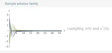

So far from Wolfram-Alpha, it can be seen their solution could resemble an exponential decay "at the end" (where oscillations disappears), but is not clear if they are really achieving a finite extinction time when its stop moving, neither if is possible to stop moving in a position different from zero.
Wolfram-Alpha plots of the solutions

    Did some numerical tests. It's not exponential decay at large $t$. It scales as $t^{-1}$. It also probably doesn't stop in finite time, though I haven't proven that yet. – eyeballfrog May 04 '23 at 23:48
  • @eyeballfrog I tried by plotting it in Octave and also look like never-ending. But I took the nonlinear term from this paper, trying to find a way to make it achieve a finite extinction time (those from the paper supposedly do it), so I were expecting that the diff. eqn. of the main question also will do it (so far, at least it stop oscillating after some finite time). But I don't know how to prove or disprove it. – Joako May 05 '23 at 01:32
    One thing it definitely does do is stop oscillating in finite time. The conditions on the transition from underdamped to overdamped behavior seem like a good thing to look at. – eyeballfrog May 05 '23 at 11:47

    It appears that for some very precise values of the initial condition, it does come to a stop in finite time. For example, with $x(0) \approx 1.4271, x'(0) = 0$, it stops without crossing the $t$-axis around $3.75$. – eyeballfrog May 05 '23 at 14:53
