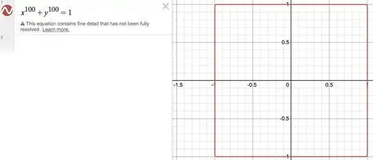

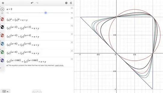

I was playing around on DESMOS and I discovered an equation for a triangle. So I got curious and was wondering if there are equations for other shapes (not necessarily regular) ? For example, a circle has the equation $x^2+y^2=a$, a square has the equation $\lim_{n \to \infty} x^n+y^n=a$ or an irregular triangle (which I discovered) has the equation $\lim_{n\to \infty}x^n+y^n=x+y$? And by extension is there any way to create the same shapes but then regular?

You can make regular stars. Maybe transforming part of the equation in the link will give you irregular shapes – Тyma Gaidash May 01 '23 at 12:27
Somewhat, although I'm not sure how to describe it cause for example, the equation of square 'approaches a perfect square' as $n$ goes to infinity – May 01 '23 at 12:29
