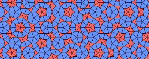

The Penrose tiling P2 is aperiodic and consists of two quadrilateral shapes: kites and darts. It is depicted in the image below, with kites in blue and darts in red:

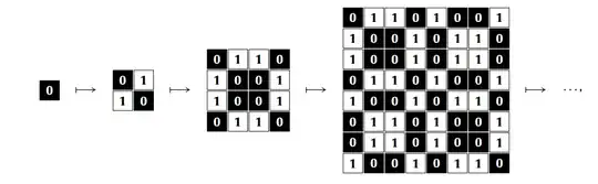

There are plenty of counterexamples to your conjecture $(2)$. If I'm honest, I don't think there's much chance of rescuing it either. There's not really much about aperiodicity that relies on some underlying irrationality of the method for producing the tiling. Of course, the converse is generally true - irrationality, say from the expansion factor of a substitution rule, or the slope of a cut-and-project generating method, will imply aperiodicity.
To give a concrete example, the two-dimensional Thue-Morse substitution gives rise to an aperiodic (repetitive) tiling with linear expansion factor $\lambda = 2$. This comes from taking the product of the Thue-Morse substitution with itself and suitably colouring the symbols. The substitution rule is as follows (the rule for the white tile is given by just inverting all colours in the rule for the black tile):
[image taken from https://arxiv.org/abs/2302.12908]
Moreover, unlike for the chair tiling, this tiling is not limit-periodic, as the 2d Thue-Morse substitution is bijective, and so the tiling dynamical system does not have discrete spectrum.
