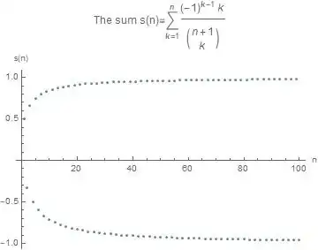

Let us calculate the sum more generally
$$s(n)=\sum _{k=1}^n \frac{(-1)^{k-1} k}{\binom{n+1}{k}}, n=1,2,3,...\tag{1}$$
The result can be written as
$$s (n) = \frac{n+2-(-1)^n \left(n^2+4 n+2\right)}{(n+3) (n+4)}= \left\{ \begin {array} {ll} -\frac{n}{4+n} & n\;\;\text {even} \\ \frac{n+1}{n+3} & n\;\;\text {odd} \\ \end {array} \right. \tag{2}$$
Here is a plot of $s(n)$
it show that for large $n$ the sum oscillates between the borders $\pm 1$.

Adding the expressions in $(5a)$ and $(5b)$ proves $(2)$ which is easy to see in the formula with the parity alternatives.
The specific value to be calculated in the OP, is $s(19) = \frac{19+1}{19+3}=\frac{20}{22}=\frac{10}{11}$.
