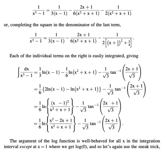

$$\int_0^{\infty} \dfrac1{x^3-1}$$
It is quite easy to find the antiderivative of this using partial fractions, enter image description here (page from "inside interesting integrals, really cool book btw)
So then as there is a singularity at $1$ I did the routine and long $\epsilon$ calculations to get the final answer of $\dfrac{\pi}{\sqrt{27}}$ but then I was quite surprised to find out that this was indeed equal to $\displaystyle\lim_{x \to \infty}F(x)-F(0)$.

It comes down to the observation that the contribution to the PV integration from the immediate vicinity of the singularity was, in this problem, just zero. This follows from the fact that you can split the integrand as a singular term (namely $\frac{1}{3(x-1)}$) plus a regular term, with the singular term being an odd function of $x-1$. Consequently the contribution to PV integration from $[1-\epsilon,1+\epsilon]$ goes to zero with $\epsilon$, so the whole PV integral, which formally is $\lim_{x \to \infty} \lim_{\epsilon \to 0^+} F(x)-F(1+\epsilon)+F(1-\epsilon)-F(0)$, is the same as $\lim_{x \to \infty} F(x)-F(0)$.
