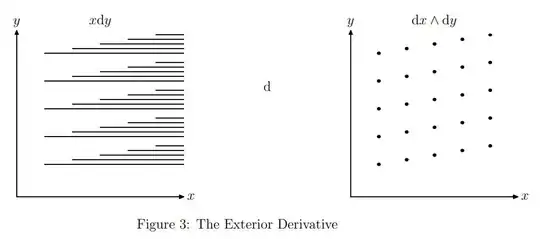

This paper provides a geometric intuition of differential forms. On page $5$ it reads:
"Consider the case $xdy$. The number of horizontal lines is roughly proportional to $y$. In other words the number of lines that 'come to an end' in any area is roughly the same wherever we look. This is just like the example $dx ∧ dy$ above. You may have guessed what is going on here: $d(xdy) = dx∧dy$. In other words exterior derivative is none other than finding the boundary of the picture."
Why can the exterior derivative of a form $\omega$, defined as
$$d\omega = d\left(\sum_{i_1,\ldots,i_k}\omega_{i_1,\ldots,i_k}dx^{i_1}\wedge\ldots\wedge dx^{i_k}\right)\\ \ \ = \sum_{i_1,\ldots,i_k}d\omega_{i_1,\ldots,i_k}\wedge dx^{i_1}\wedge\ldots\wedge dx^{i_k}\\ \ \ \ \ \ \ \ \ \ \ \ \ \ \ \ \ \ \ \ \ \ \ = \sum_{i_1,\ldots,i_k}\sum_{\alpha=1}^nD_{\alpha}(\omega_{i_1,\ldots,i_k})\ dx^{\alpha}\wedge dx^{i_1}\wedge\ldots\wedge dx^{i_k}\\ $$
be interpreted as the quantity of points at which the lines in the picture come to an end?

    I disagree with Mr. Brown. I am writing an answer for your question about $dx\wedge dy$ and hope to get to this one in due time. In short(and just thinking locally/in the flat case), every function $L_x(v)$ linear in $v$ with $x$ a point has a natural "derivative" $L_x(\nabla)$ with respect to $x$ which can be shown to essentially be the average change in $L_x(v)$ over all directions $v$. – Nicholas Todoroff Apr 21 '23 at 19:22
  • The exterior derivative is just the derivative of $L_x(v) = v\wedge\omega$, or in other words $d\omega = \nabla\wedge\omega$. Of course we also need to geometrically interpret the wedge product here. – Nicholas Todoroff Apr 21 '23 at 19:22
