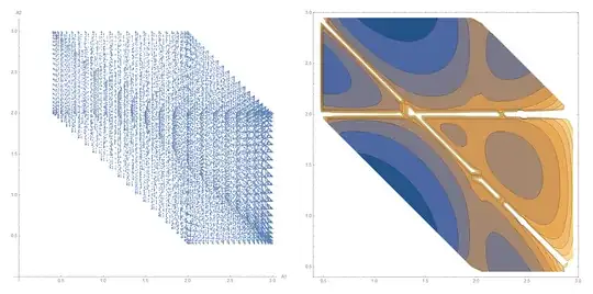

Now, we took $(s_1,s_2,s_3)=(5/2,1/2,1/3)$ and we plotted the quantity in $(4)$ (right) along with the scatter-plot of the respective mapping from the cube to the plane (left). Here we go:

(Numerically.) Clear[s]; {s[1], s[2], s[3]} = {5/2, 1/2, 1/3}; mygrid = Flatten[ Array[{#1, #2, #3} &, {50, 50, 50}, {{0, 2 Pi}, {0, 2 Pi}, {0, 2 Pi}}], 2]; myvals = Map[{1/4 Cos[2 #[[1]]] (1/s[1] - 1/s[2]) + 1/8 Cos[2 #[[1]] - 2 #[[2]]] (1/s[1] - 1/s[2]) + 1/8 Cos[2 #[[1]] + 2 #[[2]]] (1/s[1] - 1/s[2]) + 1/4 Cos[2 #[[2]]] (1/s[1] + 1/s[2] - 2/s[3]) + 1/4 (1/s[1] + 1/s[2] + 2/s[3]), 1/32 Cos[2 #[[1]] - 2 #[[2]] - 2 #[[3]]] (1/s[1] - 1/s[2]) + 1/32 Cos[2 #[[1]] + 2 #[[2]] - 2 #[[3]]] (1/s[1] - 1/s[2]) + 1/32 Cos[2 #[[1]] - 2 #[[2]] + 2 #[[3]]] (1/s[1] - 1/s[2]) + 1/32 Cos[2 #[[1]] + 2 #[[2]] + 2 #[[3]]] (1/s[1] - 1/s[2]) + 1/8 Cos[2 #[[1]]] (-(1/s[1]) + 1/s[2]) + 1/16 Cos[2 #[[1]] - 2 #[[2]]] (-(1/s[1]) + 1/s[2]) + 1/16 Cos[2 #[[1]] + 2 #[[2]]] (-(1/s[1]) + 1/s[2]) + 3/16 Cos[2 #[[1]] - 2 #[[3]]] (-(1/s[1]) + 1/s[2]) + 3/16 Cos[2 #[[1]] + 2 #[[3]]] (-(1/s[1]) + 1/s[2]) + 1/16 Cos[2 #[[2]] - 2 #[[3]]] (1/s[1] + 1/s[2] - 2/s[3]) + 1/8 Cos[2 #[[3]]] (1/s[1] + 1/s[2] - 2/s[3]) + 1/16 Cos[2 #[[2]] + 2 #[[3]]] (1/s[1] + 1/s[2] - 2/s[3]) + 1/8 Cos[2 #[[2]]] (-(1/s[1]) - 1/s[2] + 2/s[3]) + 1/8 (3/s[1] + 3/s[2] + 2/s[3]) + 1/8 (-(1/s[1]) + 1/s[2]) Sin[2 #[[1]] - #[[2]] - 2 #[[3]]] + 1/8 (1/s[1] - 1/s[2]) Sin[2 #[[1]] + #[[2]] - 2 #[[3]]] + 1/8 (1/s[1] - 1/s[2]) Sin[2 #[[1]] - #[[2]] + 2 #[[3]]] + 1/8 (-(1/s[1]) + 1/s[2]) Sin[2 #[[1]] + #[[2]] + 2 #[[3]]]} &, mygrid];
pl1 = ListPlot[myvals, ImageSize :> mim, AxesLabel :> {"A1", "A2"}, AspectRatio -> 1]; GraphicsGrid[{{pl1, pl2}}]
Again, as we can see, the match is good.
