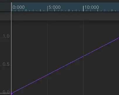

I evaluate t in a linear fashion like this:
