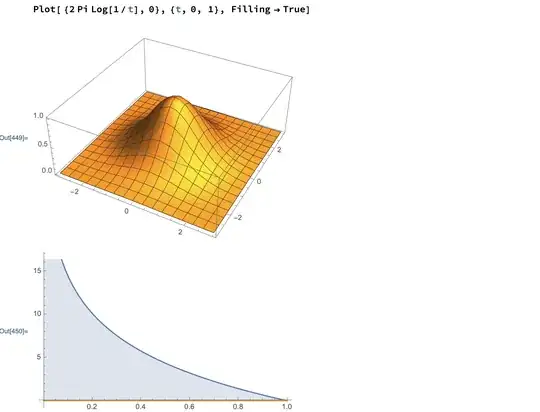

Example. It is instructive to sketch a simple special example in which we start with say $y = e^{-(x_1^2+ x_2^2)/2}$ Then a calculation shows (via the method of disks for a surface of revolution) that the distribution function is the monotone function $M_f(t) = 2\pi \ln (1/t)$ for $t<1$. As an exercise, one can check that the area under the graph of this distribution function is indeed equal to the total volume under the Gaussian function. (The distribution function redistributes mass without destroying mass.)
original function melts to its distribution function
