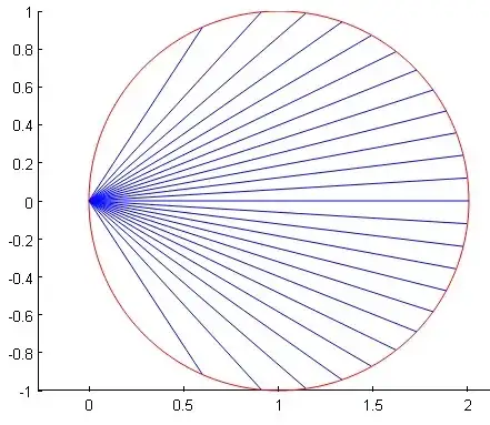

Here is a Matlab implementation (where inverse function $f^{-1}$ is denoted $g$ and computed as a separate function).
 function main
 clear all;close all;hold on;axis equal;
 u=0:pi/100:2*pi;plot(1+cos(u),sin(u),'r');
 n=26;
 f=@(t)(t+0.5*sin(2*t));
 t=-pi/2; % \theta_0
 for k=1:n-1
    t=g(f(t)+pi/n); % implem. of formula (3)
    plot([0,1+cos(2*t)],[0,sin(2*t)]);
 end;

Remark : In fact, this answer can be considered as "issued" from the answer I had given here to a completely similar question. The formulation of this answer wasn't direct enough (this explains maybe why it hadn't been upvoted) ; I think the present version, with its accompanying program, is clearer.
