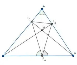

Triangle $F_AF_BF_C$ is called the orthic triangle of $\triangle ABC$. We can use properties of orthic triangle to find its mother triangles.
Theorem: For an acute $\triangle ABC$, vertices $A$, $B$ and $C$ are the excentres of its orthic triangle.
Proof:
$ACF_AF_C$ is cyclic $\implies\angle BF_AF_C=\angle BAC$
$ABF_AF_B$ is cyclic $\implies\angle CF_AF_B=\angle BAC$
(exterior angles of cyclic quadrilateral)
Therefore $\angle BF_AF_C=\angle CF_AF_C$. Thus $BC$ bisects the exterior angle of $\triangle F_AF_BF_C$ at $F_A$.
Similarly, sides of triangle $ABC$ bisect the exterior angles of triangle $F_AF_BF_C$. Hence $A$, $B$, $C$ are the excentres of $\triangle F_AF_BF_C$.
Given that, we can find the points $A$, $B$ and $C$.[1]
Also note that, if you swap points $(A,B,C)$ and $H$ you get the same orthic triangle $F_AF_BF_C$. Thus you can find a family of $4$ triangles (one acute and three obstuse) which fulfills the given condition.

I found out that my formulation is way over complicated, due to a simple fact, which is that the orthocenter of a triangle is the incenter of the orthic triangle (which is the triangle with vertices $F_A, F_B, F_C$).
Thus, the orthocenter $H$ is found immediately by finding the incenter of $\triangle F_A F_B F_C $.
Once we have the orthocenter, the vertices $A,B,C$ can be found as follows:
For vertex $A$, we have
$ A = F_B + t (F_B - H)^* = F_C + s (F_C - H)^* $
So we just solve this $2 \times 2 $ system for $t $ and $s$, and calculate $A$.
Vertices $ B $ and $C$ can be found in a similar fashion.
I've tested this method on a given triangle with sides $ 13, 14, 15$ by setting the vertices $A = (0,0), B= (14, 0), C = (5, 12) $, then calculated the feet $F_A, F_B, F_C$. I then used the above procedure to calculate the vertices, and they came out to be the vertices I started with.
