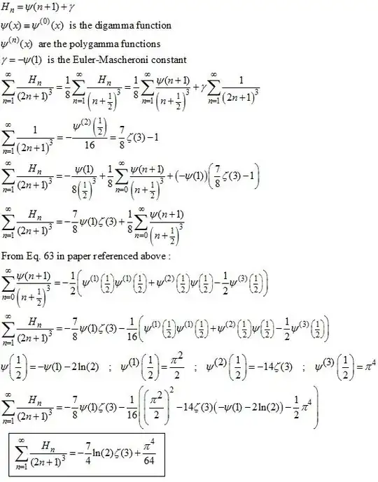

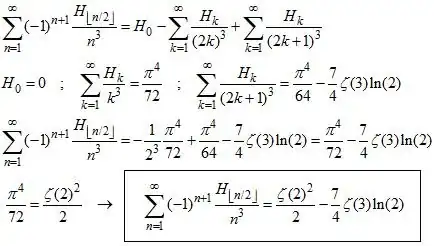

The chalenge is interresting, but easy if we know some classical infinite sums with harmonic numbers : http://mathworld.wolfram.com/HarmonicNumber.html
( typing mistake corrected)
I was sure that the formula for $\sum\frac{H_{k}}{(2k+1)^3}$ was in all the mathematical handbooks among the list of sums of the same kind. I just realize that it is missing in the article of Wolfram referenced above. Sorry for that. Then, see : http://www.wolframalpha.com/input/?i=sum+HarmonicNumber%28n%29%2F%282n%2B1%29%5E3+from+n%3D1to+infinity
One can find in the literature some papers dealing with the sums of harmonic numbers and even more with the sums of polygamma functions. The harmonic numbers are directly related to some particular values of polygamma functions. So, when we are facing a problem of harmonic number, it is a good idea to transform it to a problem of polygamma. For example, in the paper “On Some Sums of Digamma and Polygamma Functions” by Michael Milgram, on can find what are the methods and a lot of formulas with the proofs : http://arxiv.org/ftp/math/papers/0406/0406338.pdf
From this, one could derive a general formula for $\sum\limits_{n\geq 1}\frac{H_n}{(an+b)^p}$ with any $a, b$ and integer $p>2$. Less ambitious, the case $a=2 ; b=1 ; p=3$ is considered below :
