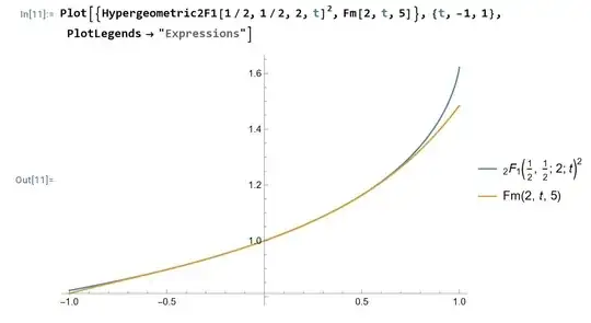

we find for the first six terms $$ \left( \begin{array}{cc} n &c_{m,n}\\0 & 1 \\ 1 & \frac{m}{8} \\ 2 & \frac{1}{128} m (m+5) \\ 3 & \frac{m (m (m+15)+59)}{3072} \\ 4 & \frac{m (m (m (m+30)+311)+1128)}{98304} \\ 5 & \frac{m (m (m (m (m+50)+965)+8590)+30084)}{3932160} \\ \end{array} \right) $$
Here is a plot for $m=2$ comparing the square of the hypergeometric function against the series expansion truncated to the first six terms enter image description here
