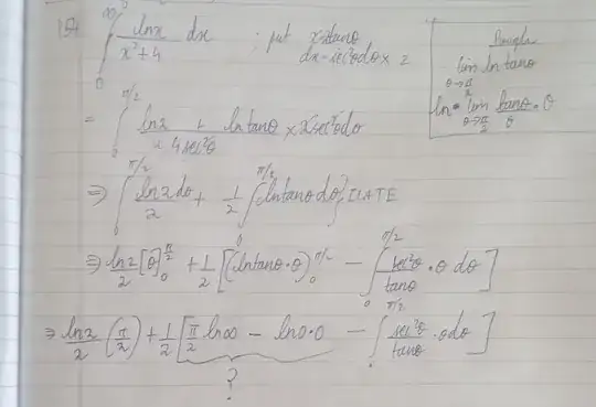

$$\int_{0}^{\infty}{\frac{\log(x)}{x^2+4}}dx$$
-from the book Advanced Problems in Mathematics by Vikas Gupta
So I tried to solve this integral by substituting $x=2\tan\theta$ so that we get the upper limit as ${\frac{\pi}{2}}$ in addition to the ability to use the formula $\log(ab)=\log a + \log b$ in the numerator. But after few manipulations I ended up with this my workout
Could you kindly advise on how to proceed further as I got $\log(\infty)$ when I used integration by parts. Also if there is a cleverer way to do this, I would love to know it!
