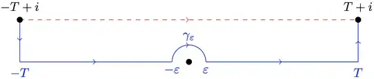

It is not hard to prove that $\sqrt{1 - e^{\pi z}}$ is analytic on the band $\mathbb{R} \times (0, 1]$. So, we can deform the contour $-T + i \to T + i$, without altering the value of the integral, to the piecewise contour (shown as the blue solid path below)
the new contour
where $\gamma_{\varepsilon}(t) = \varepsilon e^{i(\pi - t)}$, $0 \leq t \leq \pi$, stands for the clockwise-oriented upper-semicircular arc of radius $\varepsilon \ll T$ about the origin. However, the contribution from the linear segment parts,
\begin{gather*} \underbrace{\int_{-T + i}^{-T} \frac{1}{\sqrt{1 - e^{\pi z}} \sqrt{z}} \, \mathrm{d}z}_{=\mathcal{O}(T^{-1/2})} + \underbrace{\int_{-T}^{-\varepsilon} \frac{1}{\sqrt{1 - e^{\pi x}} \cdot i \sqrt{x}} \, \mathrm{d}x}_{\text{pure imaginary}} \\ \hspace{3em} + \underbrace{\int_{\varepsilon}^{T} \frac{1}{i \sqrt{e^{\pi x} - 1} \sqrt{x}} \, \mathrm{d}x}_{\text{pure imaginary}} + \underbrace{\int_{T}^{T+i} \frac{1}{\sqrt{1 - e^{\pi z}} \sqrt{z}} \, \mathrm{d}z}_{=\mathcal{O}(e^{-\pi T/2} T^{-1/2})} \tag{*} \end{gather*}
is of the form $\text{[imaginary number]} + \mathcal{O}(T^{-1/2})$, hence its real part vanishes as $T \to \infty$. So, only the contribution from the circular arc $\gamma_{\varepsilon}$ survives under the limit as $T \to \infty$ and therefore
\begin{align*} I &= \frac{1}{\sqrt{2}} \operatorname{Re} \biggl( \int_{\gamma_{\varepsilon}} \frac{1}{\sqrt{1 - e^{\pi z}} \sqrt{z}} \, \mathrm{d}z \biggr) \\ &\quad \xrightarrow{\varepsilon \to 0^+} \frac{1}{\sqrt{2}} \operatorname{Re} \biggl( (-\pi i) \, \underset{z=0}{\mathrm{Res}} \, \frac{i}{z \sqrt{\frac{\exp(\pi z) - 1}{z}}} \biggr) = \bbox[color:navy; background:#F0F8FD; padding:10px; border:1px dotted navy;]{\sqrt{\frac{\pi}{2}}}. \end{align*}
