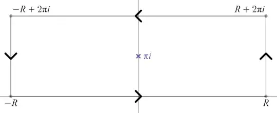

Here is an alternate and probably over-the-top method of evaluating this integral using complex analysis.
Let $I$ be the integral in question. Note that $\displaystyle \int_{-\infty}^{\infty}\frac{x^{2}e^{-x}}{\left(1+e^{-x}\right)^{2}}dx = \int_{-\infty}^{\infty}\frac{x^{2}e^{x}}{\left(1+e^{x}\right)^{2}}dx$. Let $\displaystyle f(z) = \frac{z^{3}e^{z}}{\left(1+e^{z}\right)^{2}}$. Its set of poles is $\left\{z \in \mathbb{C} : z = \pi i (2n+1)\right\}$ for all $n \in \mathbb{Z}$, but the only pole we will concern ourselves with is $z=\pi i$. Traversing counterclockwise, define a rectangular contour $C := \left\{z \in \mathbb{C} : \Re(z) \in [-R,R] \text{ } \wedge \text{ } \Im(z) \in [0,2\pi]\right\}$ visualized below.
RECTANGULAR CONTOUR

$$2\pi i \operatorname{Res}(f(z), z = i\pi) = \left(\int_{-R}^{R}+\int_{R}^{R+2\pi i}+\int_{R+2\pi i}^{-R+2\pi i}+\int_{-R+2\pi i}^{-R}\right)f(z)dz.$$
We can prove that the integrals over the vertical line segments go to $0$ as $R \to \infty$. (I can type out a proof if someone wants me to.)

    @Cryo Thank you very much for catching my error. The rest of the answer should be correct after double-checking. I think the main thing to take away from this answer is that if you see an integral over $(-\infty, \infty)$ that has in the denominator only $e^x$ and some constants, constructing a rectangular contour like the screenshot I have in the post could be a good idea because $e^{x + 2\pi i} = e^x$. But what do you mean by a quadratic pole evaluating to $0$ and there's a $1/z$ pole there? – Accelerator Mar 11 '23 at 16:52
