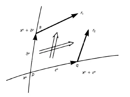

We next look at the geometrical meaning of the torsion tensor. Let $p \in M$ be a point whose coordinates are $\{x^μ\}$. Let $X = \varepsilon^μ e_μ$ and $Y = \delta^μ e_μ$ be infinitesimal vectors in $T_pM$. If these vectors are regarded as small displacements, they define two points $q$ and $s$ near $p$, whose coordinates are $\{x^μ + ε^μ\}$ and $\{x^μ + δ^μ\}$ respectively (following figure). If we parallel transport $X$ along the line $ps$, we obtain a vector $sr_1$ whose component is $\varepsilon^μ − \varepsilon^{\lambda} \Gamma^{\mu}_{\nu \lambda} \delta^{\nu}$ . The displacement vector connecting $p$ and $r_1$ is
$$pr_1 = ps + sr_1 = δ^μ + ε^μ − \Gamma^{\mu}_{\nu \lambda} \varepsilon^{\lambda} \delta^{\nu} .$$
Similarly, the parallel transport of $δ^μ$ along $pq$ yields a vector
$$pr_2 = ps + sr_2 = ε^μ + δ^μ − \Gamma^{\mu}_{\lambda \nu} \varepsilon^{\lambda} \delta^{\nu} .$$
In general, $r_1$ and $r_2$ do not agree and the difference is
$$r_2r_1=pr_2-pr_1=(\Gamma^{\mu}_{\nu \lambda}− \Gamma^{\mu}_{\lambda \nu})\varepsilon^{\lambda} \delta^{\nu}=T^{\mu}_{\lambda \nu} \varepsilon^{\lambda} \delta^{\nu} \qquad(*)$$
Thus, the torsion tensor measures the failure of the closure of the parallelogram made up of the small displacement vectors and their parallel transports.

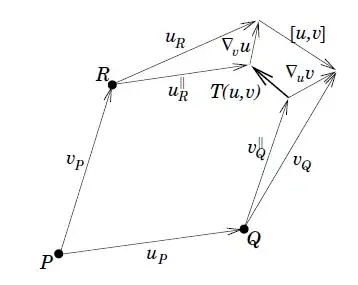

Now with respect to the above description it is easy to imagine the Torsion tensor in terms of the Lie bracket and connection:
$$T(u,v)=\nabla_u v −\nabla_v u−[u,v]$$

Suppose we are navigating on the surface of the Earth. We define a vector to be parallel transported if the angle between the vector and the latitude is kept fixed during the navigation. [Remarks: This definition of parallel transport is not the usual one. For example, the geodesic is not a great circle but a straight line on Mercator’s projection.] Suppose we navigate along a small quadrilateral $pqrs$ made up of latitudes and longitudes (following figure).
We parallel transport a vector at $p$ along $pqr$ and $psr$, separately. According to our definition of parallel transport, two vectors at $r$ should agree, hence the curvature tensor vanishes. To find the torsion, we parametrize the points $p$, $q$, $r$ and $s$ as in following figure.
We find the torsion by evaluating the difference between $pr_1$ and $pr_2$ as in $(*)$. If we parallel transport the vector $pq$ along $ps$, we obtain a vector $sr_1$, whose length is $R \sin \theta d\varphi$. However, a parallel transport of the vector $ps$ along $pq$ yields a vector $qr_2 = qr$. Since $sr$ has a length $R \sin(\theta − d\theta) d\varphi \simeq R \sin \theta d\varphi − R \cos \theta d\theta d\varphi$, we find that $r_1r_2$ has a length $R \cos \theta d\theta d\varphi$. Since $r_1r_2$ is parallel to $-\frac{\partial}{\partial \varphi}$, the connection has a torsion $T^{\varphi}_{\theta \varphi}$, see $(*)$. From $g_{\varphi \varphi} = R^2 \sin^2 \theta$, we find that $r_1r_2$ has components $(0,−\cot \theta d\theta d\varphi)$. Since the $\varphi$-component of $r_1r_2$ is equal to $T^{\varphi}_{\theta \varphi} d\theta d\varphi$, we obtain $T^{\varphi}_{\theta \varphi} = −\cot \theta$.

  • @Bakhoda: I have a question for you: what are $u_R$ and $u_R^{\parallel}$ supposed to represent? I imagine that $u_R^{\parallel}$ is the parallel transport of $u$ along the geodesic with initial vector $v$, but what about $u_R$? – Jesse Madnick Sep 13 '13 at 09:20
  • @ Jesse Madnick: $u$ is a vector field and $u_R$ is a vector that the vector field $u$ associate to point $R$. – Sepideh Bakhoda Sep 13 '13 at 10:13
