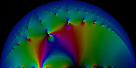

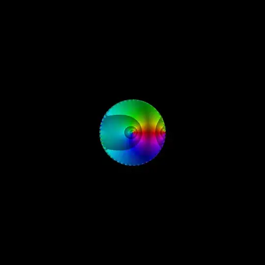

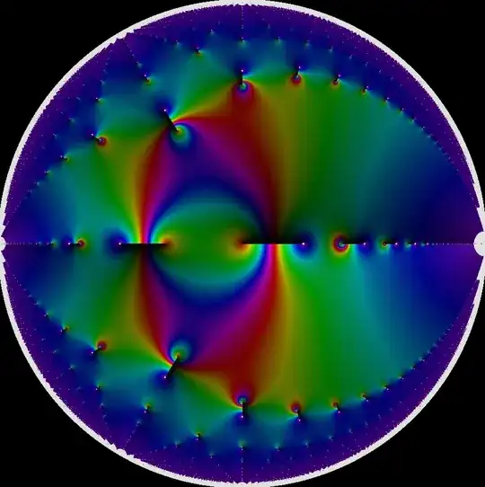

Now to the interesting part-- pictures! enter image description here This is a graph of the original function, before continuation. And this is what the continuation looks like:enter image description here

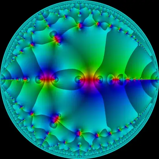

There are some really striking patterns in the locations of the zeroes and poles. For instance, if I change some of the domain coloring properties, I get this beautiful picture of the function (where only the top half is graphed, since the rest is symmetric) enter image description here
Now, the real interesting question is 'Can we continue this function beyond its natural boundary? What does the function look like there?' I don't know the answer to these questions, but I hope to make some progress on them soon.
Explanation of the Pictures
Picture 1 and Picture 2 share the same coloring method. In HSB (Hue, Saturation, Brightness), the function I'm using is (with 255 as the highest value) $$F(re^{i \theta}) = \left[ 255\frac{\theta}{2\pi},250,125 + mod(155|\ln(r)|,255) \right]$$ So, the hue corresponds to the angle. The brightness corresponds to the log of the size. The breaks in color you appear to see come from the mod(x,255) term. This means the color resets backward when it becomes too large. This makes it easy to detect poles and zeroes, since their will be lots of these breaks close together near poles and zeroes, since there the log of the size becomes infinite.
In the second picture, I make the hue correspond to the angle. This is why you see those cuts-- the angle isn't a continuous function. In particular, if you go around a circle, the angle goes from $0$ to $2 \pi$, but then jumps back to $0$. So the lines correspond to points where the angle is jumping from $0$ to $2 \pi$. Thus, along every cut, the function is purely real with a positive real part.
The cuts connect together the poles and zeroes in this function. In particular, if I draw the poles in white, then I obtain this graph: enter image description here (Ignore the white near the boundary, that is just because it becomes too hard to compute the function accurately there). I think that's pretty interesting, the poles and zeroes seem to come in pairs, and those pairs seem to be connected

  • What are the short straight lines in the last picture ?? that does not look analytic ? All the poles are at |z| = 2 right ? What is the striking patterns of poles and zero's ? Is there a functional equation for the function or for the zero's ? This looks like many lambert series at first ? Such as j-invariant. I did notice that the second layer contains about twice as many zeros as the first layer. And every zero seems to a member of 3 " straight" lines on a sphere. I think this 2 and 3 come from 2^n and z/2, suggesting that if we plot the 5 analogue we get similar patters but with 5 and 4. – mick Mar 08 '23 at 23:34
    @mick I'll append an explanation of the colorings to my answer – Caleb Briggs Mar 09 '23 at 02:17
  • oh wow so the lines connect zeros and poles ! I did not expect the poles so far from the boundary. Not even after I have seen your resummation. Maybe I am missing something. – mick Mar 09 '23 at 21:59
    @mick The poles happen when $1- \frac{x^{k+1}}{2^{k-1}}$, so this means that $1 = 4 (x/2)^{k+1}, 2\cdot \sqrt[k+1]{\frac{1}{4}}= x$. So, this is less than 2 in absolute value, and as you take n to become large, these poles become closer and in absolute value to 2, but also get more and more dense. – Caleb Briggs Mar 10 '23 at 00:55
