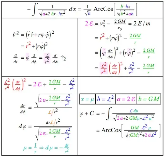

All of the following is simply context, to show how the identity us used in treating the Kepler problem. The derivations are based on what is given by Joos. My derivation used a unit mass for most of the calculation. That is, for example, angular momentum becomes $\frac{\mathfrak{L}}{m}:=\vec{\mathcal{L}}.$

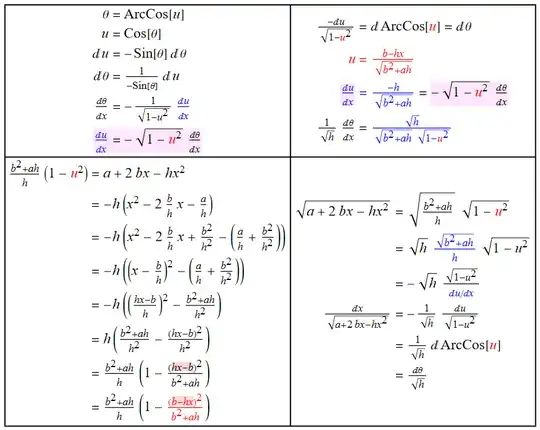

One method of producing the formula in question:
Read the right-hand side of equation in the lower left box from bottom to top. This is a result of an answer to a question about the same formula asked over six years ago.
Deriving the (un)familiar arc-cosine integral identity

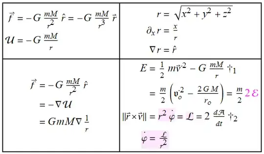

The setup of the Kepler problem:
We assert the central force law of areas (Kepler's second law) as given.
$\dagger_1$ Conservation of energy. $\dagger_2$ Central force law of areas.
Putting the Kepler problem in the advertised form:

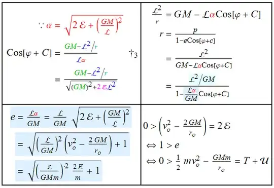

Integrating to obtain the expression for an elliptical orbit (Kepler's first law):

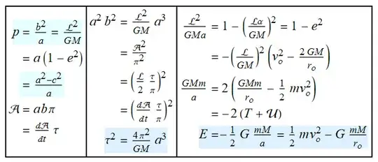

Obtaining the relationship of time to the semi-major axis (Kepler's third law):

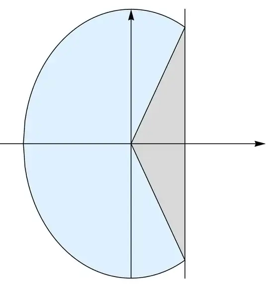

The filled region (blue $\cup$ gray) is
$$2\int_{-p}^{s}\sqrt{1-\frac{x^{2}}{p^{2}}}dx.$$
The gray triangle is
$$s\sqrt{1-\frac{s^{2}}{p^{2}}}.$$
Figuring out how to illustrate the second part may take a bit more time.

For an ellipse of the form $\frac{x^2}{p^2} +{y^2}=1$, the following integral relationship holds
$$\int_{-p}^s \frac1{\sqrt{1-\frac{x^2}{p^2}}}dx = 2\int_{-p}^s {\sqrt{1-\frac{x^2}{p^2}}}dx -s \sqrt{1-\frac{s^2}{p^2}} $$ where the RHS is the area section of the ellipse on the left side of the vertical line $x=s$ minus the triangle area with the top vertex at the origin and the base $x=s$. Thus, the integral on the LHS is the left part of the elliptical area cut out by the two lines $y= \pm \frac {y\left(s\right)}sx$ starting from the origin.
Likewise, note that $\sqrt{a+2bx-hx^{2}} $ corresponds to the scaled ellipse $$h {\left(x-\frac bh \right)^2}+{y^2}=\frac{ah+b^2}{h} $$ with its center at $(\frac bh, 0)$ and left vertex at $ s_l = -\frac{\sqrt{ah+b^2}}h+\frac bh $. The corresponding integral
$$\int_{s_l}^{s}\frac{1}{\sqrt{a+2bx-hx^{2}}}dx =\int_{s_l}^{s}\frac{1}{\sqrt{\frac{ah+b^2}h-h\left(x-\frac bh\right)^2}}dx $$ has a similar geometric interpretation, i.e. the area cutout of the ellipse.
Quanto

This is not an answer. I am just responding to the answer by Quanto. I was having trouble getting my graphic to appear in the original post. So I moved my comments here.

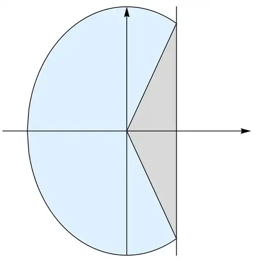

Discussion of Quanto's answer
This is what I believe the first part of the answer means.
I have no idea why my image is not displaying. This is another capture of the same graphic. Perhaps there is something strange going on with the data in the first one.
