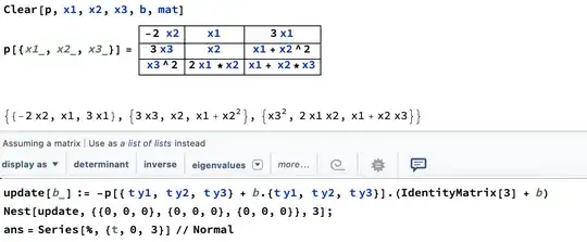

Consider $Y= f(X) = X+ A(X).X$ whose component formulas are
$[y1,y2,y3]= [x1,x2,x3]+ [3 \text{x1} \text{x3}-\text{x1} \text{x2},\text{x3} \left(\text{x1}+\text{x2}^2\right)+3 \text{x1} \text{x3}+\text{x2}^2,2 \text{x1} \text{x2}^2+\text{x3} (\text{x1}+\text{x2} \text{x3})+\text{x1} \text{x3}^2]$
This factors as $X+ A(X).X$ in many ways, one of which is $$A(X)=\begin{array}{ccc} -2 \text{x2} & \text{x1} & 3 \text{x1} \\ 3 \text{x3} & \text{x2} & \text{x1}+\text{x2}^2 \\ \text{x3}^2 & 2 \text{x1} \text{x2} & \text{x1}+\text{x2} \text{x3} \\ \end{array}$$
The Mathematica code that defines the perturbation matrix A (called p in the code) and the recursion function (3) is given below.enter image description here

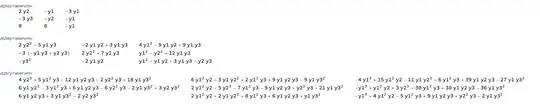

After the first three steps of recursion are completed, the truncated third-order answer $B_3$ is obtained. In the image below, we reveal the total answer in pieces, as linear $(b_1)$, quadratic $(b_2)$, and third order $b_3$:
Later I checked (by Mathematica) that the composition of the original series and the inverse series actually returned the identity map (modulo higher-order terms of fourth order).
