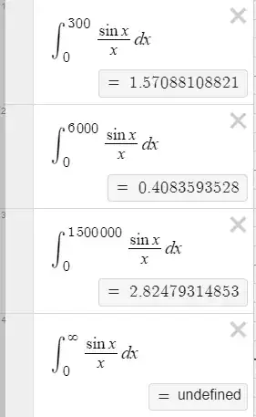

$\newcommand{\d}{\,\mathrm{d}}$I can tell you from long personal experience that Desmos is really really really really bad at doing trigonometric integrals over large domains. For example, we all know: $$\int_0^\infty\frac{\sin x}{x}\,\mathrm{d}x=\frac{\pi}{2}$$But:
If you play around with the size of the upper bound, Desmos' answer wavers between $0$ and $3$, roughly, and the differences don't at all converge. For reference, $\pi/2\approx1.570796$.

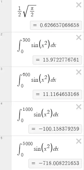

Let's try some others. For example: $$\int_0^\infty\sin(x^2)\d x=\frac{1}{2}\sqrt{\frac{\pi}{2}}$$
Yet:
Which is atrocious.
I could give more examples, but I hope I've made my point: if your integrand features trigonometric quantities that don't really rapidly decay, don't use Desmos, use Wolfram or some other computer.
