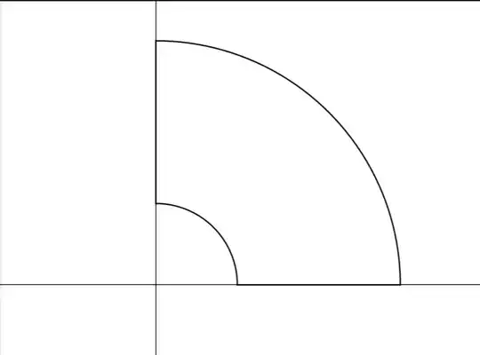

This is the contour I am using. Consider the outer circle as a contour $\Gamma$. Let the smaller semicircle be $\gamma$. Let the radius of the big semicircle be $R$ and the radius of the smaller semicircle be $r$. Then $$\int_0^\infty f(z)dz=\lim_{(r,R)\rightarrow(0,\infty)}\left(\int_\Gamma+\int_\gamma+\int_r^Rf(z)dz+\int_{ri}^{Ri}f(z)dz\right)=2\pi i\sum_k\text{Res}(f, z_k)$$Where $f(z)=\dfrac{z!}{z^z}$, $0^0=1$, and $z_k$ are the poles of $f(z)$. After that I am stuck as I don't think $f(z)$ has any poles. Any ideas?

You have to be really careful of $x^{-x}=\exp(-x\log x)$ as it features branch cuts. It is not holomorphic over the whole plane – FShrike Feb 14 '23 at 17:12

@FShrike About your note, does this mean that the integral doesn't exist? Or do we have to take a different path? I am a bit new to Complex Analysis. – Kamal Saleh Feb 14 '23 at 17:22
1@KamalSaleh The integral exists because $x!/x^x$ is continuous on $[0,\infty)$ and decays very sharply for large $x$. But what it means is, depending on how you define $\log$, you may have to be wary. This may or may not affect residue calculations, because e.g. $x^x$ (principal value) is not holomorphic on $(-\infty,0]$ – FShrike Feb 14 '23 at 17:25
Indeed, sometimes we like branch cuts because they allow us to exploit the asymmetries to compute integrals (see "dogbone contours" for examples of this). I was just throwing it out there. To safely do this contour integration you're also going to need to know how to bound $\Gamma$ (which I don't...) – FShrike Feb 14 '23 at 17:26
You don't need a small quarter-circle contour centered at $0$. There is a removable discontinuity at that point. – Accelerator Feb 14 '23 at 23:39
