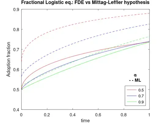

The conjecture of the OP is wrong. The attached graph proves it; it compares the numerical resolution of equation (3) with the hypothesis (5), showing that they are different functions. graph comparing
The calculations are preformed using the following code:Garrappa, Roberto, Numerical solution of fractional differential equations: a survey and a software tutorial, ZBL06916890., and code by the same author to calculate the Mittag-Leffler function.
I then added two scripts to calculate and plot and ran them with Octave 7.3.0:

%plot function solving FDE for various alphas alpha_color = ['r', 'b', 'g'] %colors for the different alphas for i = 1:size(alpha,2) [t, y] = flmm2(alpha(i), f_fun, J_fun, t0, T, y0, h, param); plot(t, y, alpha_color(i)) hold on end
%plot presumed Mittag-Leffler solution for i = 1:size(alpha,2) mittag = 1 ./ (1 + FCealphaML (t, alpha(i), lambda)); plot(t, mittag, 'color', alpha_color(i), 'linestyle', '--') hold on end
hold off title('Fractional Logistic eq.: FDE vs Mittag-Leffler hypothesis') xlabel('time') ylabel('Adoption fraction') legend (num2str (alpha'), 'title', strcat('\alpha', "\n", '- - ML'), 'location', 'southeast') legend(labels);
%FCealphaML -- Copyright Giovanni Ciriani %calculates Queen ML funtion e_alpha = ML_alpha(-t^alpha) as defined in (2) of %Mainardi, F. (2020). Why the Mittag-Leffler Function Can Be Considered %the Queen Function of the Fractional Calculus? Entropy, 22(12), 1359. %https://doi.org/10.3390/e22121359
function E = FCealphaML (t, alpha, lambda) ; E = ml (t.^alpha.*lambda, alpha, alpha, 1); endfunction
