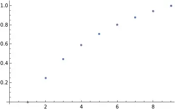

While tinkering with Mathematica I found that it could evaluate sums of the form $$\sum\limits_{k = 1}^{\infty} \frac{H_k H_{k+m}}{k^2}$$ for some nonnegative integer $m$. As it turns out (or the evidence is overwhelmingly in favor of it), this sum is always a linear combination of a constant term and the first three $\zeta$-values, i.e. $\zeta(2)$ through $\zeta(4)$. The coefficients of the $\zeta$-values were not too hard to figure out with the help of the OEIS and a bit of intuition. We have $$\sum\limits_{k = 1}^{\infty} \frac{H_k H_{k+m}}{k^2} = -C -\left(\sum\limits_{k = 1}^{m}\frac{1}{k^2}\right)\zeta(2) + 2\left(\sum\limits_{k = 1}^{m}\frac{1}{k}\right)\zeta(3) + \frac{17}{4}\zeta(4)$$ with just the non-zeta term $C$ being undetermined. For $m = 1,\ldots,9$ this constant takes on the values $$C = 0,\frac{1}{4},\frac{4}{9},\frac{341}{576},\frac{679}{960},\frac{25921}{32400},\frac{19879}{22680},\frac{95594629}{101606400},\frac{182134073}{182891520}$$ which... isn't all that insightful, to say the least. Visually, this looks like
This looks like logarithmic growth which is typical for harmonic sums. But it does not seem to be a simple combination in this case.
