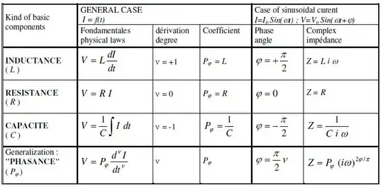

Intuitive interpretation in physic, in case of MIXED phenomena which models are some functions, classical derivatives and/or classical antiderivatives of them. This leads to a common behaviour represented by fractional derivatives. A clear example can be shown in electrical impedance analysis : Next Table comes from
http://fr.scribd.com/doc/14686539/The-Fractional-Derivation-La-derivation-fractionnaire
Some models for mixed electrical phenomena are discussed in the paper : http://fr.scribd.com/doc/71923015/The-Phasance-Concept
