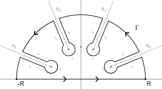

For convenience, I created this graphic of what the contour looks like. It can also be viewed here.
By Cauchy's Residue Theorem, we have
$$2\pi i\operatorname{Res}(f(z),z=i) = \left(\int_{-R}^{R}+\sum_{k=1}^{8}\int_{\lambda_k}+\sum_{m=0}^{3}\int_{\gamma_m}+\int_{\Gamma}\right)f\left(z\right)dz.$$
