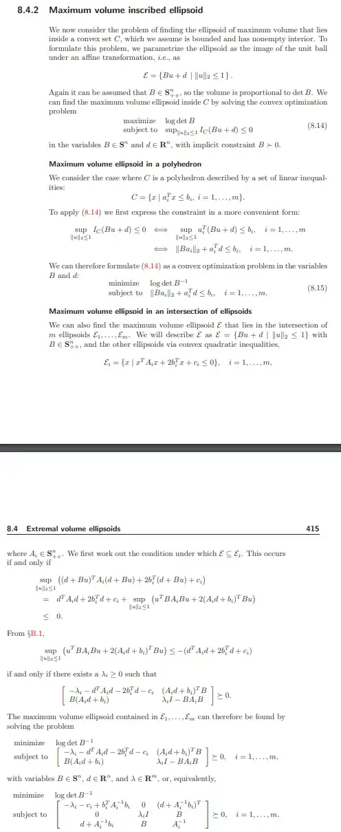

I need to find the maximum volume inscribed ellipsoid subject to linear inequality constraints and a constraining ellipsoid. I've been stuck on this for quite some time and have made very little progress.
I have it worked out for the linear constraints, but am having issues with the ellipsoidal constraint.
I'm trying to follow section 8.4.2 of Boyd & VandenbergheMaximum volume inscribed ellipsoid, subsection: Maximum volume ellipsoid in an intersection of ellipsoids.
section 8.4.2: Maximum volume inscribed ellipsoid, subsection: Maximum volume ellipsoid in an intersection of ellipsoids
Originally I had NxN PSD matric B and Ndim vector d being the optimization variables (shape and location of ellipse), but I needed to introduce another scalar variable $\lambda$ to follow the book. Additionally I added parameters P and b (where P would be A_1 in the excerpt, as there is only one ellipsoid constraint in my case, and b I think would be b_1 but could be c_1) being the constraining ellipsoid's shape and location. Lastly added a parameter c for the constraining ellipsoid.
I don't understand the purpose of λ and c; I assume they are scaling factors, but I was under the impression that matrices B and P determine the size of the ellipses. I have no idea what the value of c should be set to; my best guess it 1, but running that code says it's infeasible when it clearly is when I plot the ellipse (I get the values to plot like so:
    B.value @ np.array([ np.cos(angles) , np.sin(angles) ]) + d.value @ np.ones( (1, noangles) )
which is another reason that λ and c are confusing me; where do I use them?).
