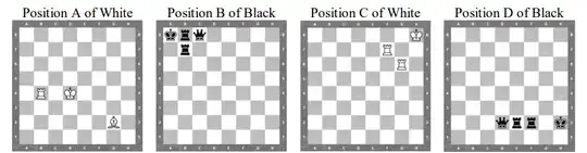

  1. Chess. Certain combinations of pieces and positions of chess are intransitive. See for instance this paper by Poddiakov. Here is an example of such an intransitive set of positions:

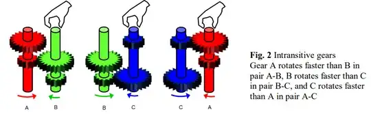

  1. Gears. The intransitivity of the rotation speed of certain constellations of gears is described on p. 5 of the following article. Here is an example:

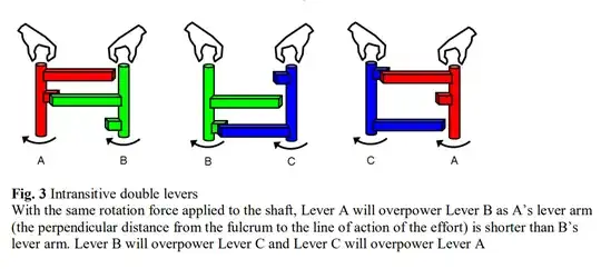

  1. The aforementioned article describes many more instances of intransitivity, including intransitive levers, pulleys, wheels, axles, wedges, and ramps. Below one finds an instance of intransitive double levers:

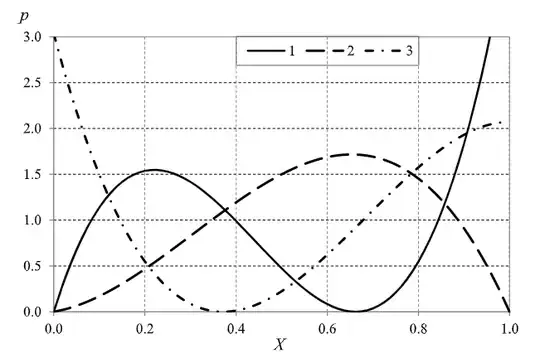

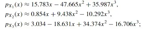

  1. One could also interpret the intransitive dice as discrete variables, and generalize them to the continuous case. Gorbunova and Lebedev describe continuous RVs with polynomial densities in this article. The define $$P_{X_{1} X_{2} X_{3}} := \min[ P(X_{1} < X_{2}), P(X_{2} < X_{3}), P(X_{3} < X_{1}) ] > \frac{1}{2} $$ and obtain a lower bound for the maximum of this value when $X_{1}, X_{2},$ and $X_{3}$ have polynomial densities, where the polynomials have degree three and four. For degree three, this is what the optimal collection of polynomials looks like (approximately):
Here's what these polynomials look like graphically:
For some reason, I can't center the above image horizontally.
