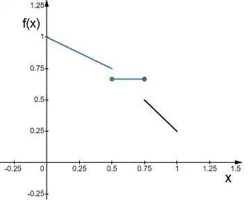

It is not true that if every point of period $2$ of $h$ is a fixed point, then $\{y_{n,x}\}_{n=0}^\infty$ is convergent for every $x \in [a,b]$.
Here is a counterexample.
$\quad$enter image description here
Let $f:[0,1]\to[0,1]$, \begin{array}{crcl} f: &[0,1] &\to &[0,1]\\ &x &\mapsto &1-\frac x2 &\text{if } x<\frac12\\ &x &\mapsto &\frac 23 &\text{if } \frac12\le x\le\frac34\\ &x &\mapsto &\frac54-x &\text{if } \frac34< x\\ \end{array}
The only periodical point of $f(x)$ is $x=\frac23$ with $f(\frac23)=\frac23$.
If $x=y_{0,x}=0$, then $y_{2n+1,x}=\frac34+\frac1{2^{n+2}}$ and $y_{2n,x}=\frac12-\frac1{2^{n+1}} $ for all $n\ge0$. $$\lim_{n\to\infty}y_{2n,x}=\frac12\not=\frac34=\lim_{n\to\infty}y_{2n+1,x}$$
Hence $f$ is a counterexample.
Let $g(x):[0,1]\to[0,1]$ be the same as $f(x)$ except for $\frac12\le x\le\frac34$, $g(x)=\frac23-\frac13(x-\frac23)=\frac89-\frac x3$.
What have been said above about $f$ also holds for $g$. In particular, $g$ is also a counterexample. (As mentioned by OP, neither $f$ nor $g$ can be continuous. In fact, both are discontinuous at $x=\frac12$ and $x=\frac34$.)
Note that while $f$ is weakly decreasing, $g$ is strictly decreasing.
