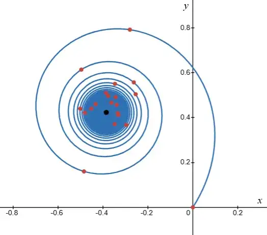

The continuous case is interesting $$\frac x{\sqrt{\pi }}=\cos \left(\frac{1}{8}\right) \left(C\left(\frac{2 n+1}{2 \sqrt{\pi }}\right)-C\left(\frac{3}{2 \sqrt{\pi }}\right)\right)+$$ $$\sin \left(\frac{1}{8}\right) \left(S\left(\frac{2 n+1}{2 \sqrt{\pi }}\right)-S\left(\frac{3}{2 \sqrt{\pi }}\right)\right)$$ $$\frac y{\sqrt{\pi }}=\sin \left(\frac{1}{8}\right) \left(C\left(\frac{3}{2 \sqrt{\pi }}\right)-C\left(\frac{2 n+1}{2 \sqrt{\pi }}\right)\right)+$$ $$\cos \left(\frac{1}{8}\right) \left(S\left(\frac{2 n+1}{2 \sqrt{\pi }}\right)-S\left(\frac{3}{2 \sqrt{\pi }}\right)\right)$$ where $C(.)$ and $S(.)$ are the cosine and sine Fresnel integrals.
If you make the parametric plot, you will see interesting features.
When $n\to \infty$,$x\to -0.384891$ and $y\to 0.423868$.
Here is a plot of the spiral, with the first $20$ unit distance markers shown as red points.
Dan
  • 35,053
  • Just to confirm, when $n$ increases by $1$, the length along the spiral increases by $1$, right? – Dan Jun 27 '24 at 09:16
    @Dan. By the definition of the continuous $x_n$ and $y_n$, along the spiral, the arclength between two points is $1$. But this is not the case with the Euclidean distance – Claude Leibovici Jun 28 '24 at 03:29
