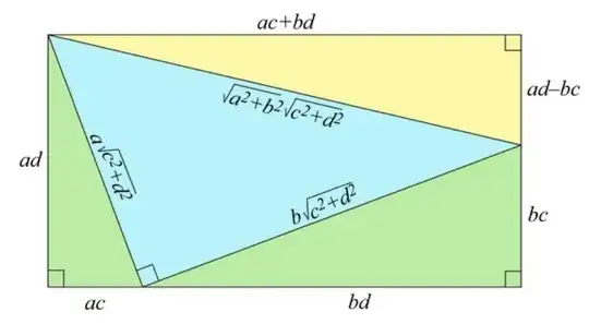

Noting that $a^2+b^2=2c^2 \Rightarrow a $ and $b$ are of same parity. Hence there exists natural numbers $u$ and $v$ such that $$a+b=2u \textrm{ and } a-b=2v$$ Then $$a=u+v \textrm{ and }b=u-v$$ $$ \begin{gathered} (u+v)^2+(u-v)^2=2 c^2 \Rightarrow u^2+v^2=c^2 \end{gathered} $$ There exists Pythagorean triple such that $$ \begin{aligned} & \left\{\begin{array}{l} u=2k m n \\ v=k(m^2-n^2) \\ c=k(m^2+n^2) \end{array}\right. \Rightarrow \left\{\begin{array}{l} a=k(2 m n+m^2-n^2 )\\ b=k(2 m n-m^2+n^2) \\ c=k(m^2+n^2) \end{array}\right. ,\\ & \end{aligned} $$ where $k,m,n \in N$. enter image description here
By the above diagram, we have $$(ac+bd)^2+(ad-bc)^2=(a^2+b^2)(c^2+d^2)= (ac-bd)^2+(ad+bc)^2$$
Combining them give the solution of $a^2+b^2=c^2+d^2=2x^2$.
