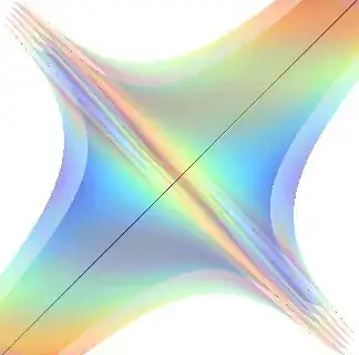

I have investigated in a graphical way the relative "positions" of the families of matrices $M_{x,y,z}$ such that
$$x^3+y^3+z^3-3xyz = k$$
for different values of constant $k$.
The result is displayed on the figure below under the form of "russian dolls" surfaces, a kind of "foliation" of space $\mathbb{R^3}$ ; in a progressive manner, these surfaces "take their distance" wrt the degenerate case, with plane $x+y+z=0$ as their asymptotic plane, and a chimney-like part around the line $x=y=z$ (featured in black).
Fig. 1 : Surfaces $x^3+y^3+z^3-3xyz = k$ for $k=-8,-4,0,4,8$.
Edit : All these surfaces are surfaces of revolution around the line defined in (9) as established in this answer.
